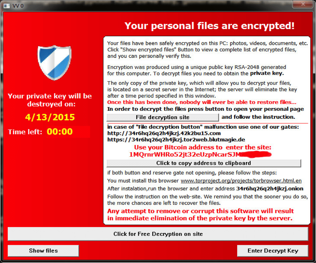

La personne m’appelle, elle me signale avoir tous ses fichiers cryptés et cette fenêtre :
TeslaCrypt
Your personal files are encrypted!
Your files have been safely encrypted on this PC: photos, videos, documents, ect. Click « Show encrypted files » Button to view a complete list of encrypted files, and you can personnaly verify this. Encryption was produced using a unique public key RSA-2048 generated for this computer.
To decrypt files you need to obtain the private key. […]
