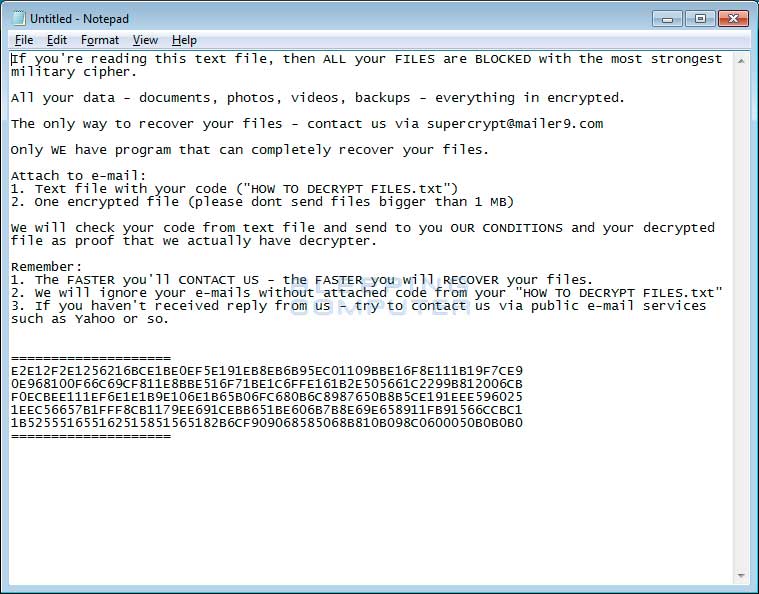

Voici le type de fichier txt que vous pouvez trouver :
ransom-note
Avec le contenu suivant :
If you’re reading this text file, then ALL your FILES are BLOCKED with the most strongest military cipher.
All your data – documents, photos, videos, backups – everything in encrypted.
The only way to recover your files – contact us via [email protected] Only WE have program that can completely recover your files.
Attach to e-mail:
1. Text file with your code (« HOW TO DECRYPT FILES.txt »)
2. One encrypted file (please dont send files bigger than 1 MB)
We will check your code from text file and send to you OUR CONDITIONS and your decrypted file as proof that we actually have decrypter. Remember:
  1. The FASTER you’ll CONTACT US – the FASTER you will RECOVER your files.
  2. We will ignore your e-mails without attached code from your « HOW TO DECRYPT FILES.txt »
  3. If you haven’t received reply from us – try to contact us via public e-mail services such as Yahoo or so.
==================== A4A14D4E4445416ACE4AA0AD4A494AB8AB5B94EC01409BBA15D8A144B19D7CA9 0E968400D66C59CD841A8BBA446D74BA1C6DDE464B4E404554C4499B844006CA D0ACBEE444AD5A1A4B9E105E4A54B06DC680B5C8987640B8A4CA194AAE496044 4EAC46647B1DDD8CA4479AE691CEBB644BE605B7A8A69A548914DB94456CCAC1 1B4454441544454644841454184B6CD909068484068A840B098C0600040A0A0B0 ====================
